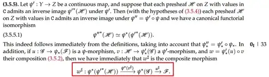

My problem is that I don't know how to prove it. For what this MSE post says, there are really not a lot places to learn about the issue of composing morphisms of ringed spaces. The only place I've found that mentions the exact issue I'm asking about is EGA 0, 3.5.5 (here a version in English):
The critical expression in which it is proven the fact about I'm asking for is squared in red. The thing is that I don't understand where the “then we have immediately that $w^\sharp$ is the composite morphism” comes from.
Some notes on what is Grothendieck considering there: Instead of ringed spaces, he considers general “sheafed spaces” and morphisms of “sheafed spaces,” which are just a generalization to the case of ringed spaces. A “sheafed space” is a pair $(X,\mathscr{F})$, where $X$ is a topological space and $\mathscr{F}$ is a sheaf on $X$ valued on some category $\mathsf{C}$, and the definition of a morphism between sheafed spaces is, mutatis mutandis, the same as the definition we have wrote here for ringed spaces. The category of “sheafed spaces” is also addressed in EGA 0, 3.5.2.
