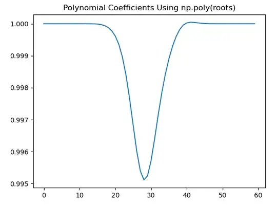

As a simple example, and showing where I begin to see issues: I start with a 59th order polynomial with unity coefficients: $1+x+x^2+\ldots x^{59}$
The roots of this will be the 60th roots of unity given as $e^{jn2\pi/60}$ with n from 1 to 59, which I also get from Python using np.roots which are then given as complex double precision floating point representation (real and imaginary are both double precision). I then used the roots to poly function within python and would expect to get the unity coefficients back, but instead get large errors in the middle of the polynomial (yes, consistent with where we would have the biggest sum of products).
np.poly
I then used my own approach of iteratively convolving coefficients while watching for dynamic range issues. For example in the plot below, I first show the resulting polynomial if only the first half of the roots were used, with the magnitude in dB to show that the dynamic range is far below the 300 dB+ allotted by double precision floating point. The lower portion of this plot shows the result of convolving this polynomial returned by the first 30 roots with the similar polynomial returned by the second 30 roots with no improvement in error.
poly through convolution

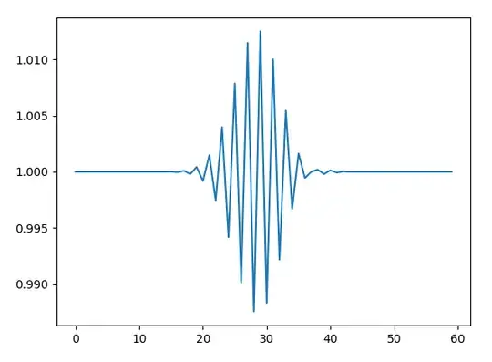

I went on to iteratively convolve each of the complex roots $z_n$, by convolving the first two (as $x-z_1$ and $x-z_2$), and then convolving the result of that with the next root (as $z^2-(z_1+z_2)+z_1 z_2$ and $x-z_3$), etc through all of the roots, as given in Python below:
def cz(roots):
    z = list(roots)
    result = [1]
    while z:
        result = np.convolve(roots, [1, -z.pop()])
    return result
This resulted in even more error:
my version of conversion
My question is two fold: what is the source of this numerical error and are their improved mathematical techniques that I could use for converting large numbers of roots (I would like to be able to extend this to 100s of roots) to its polynomial form? I used the roots of unity in this simple example, but more generally I would like to be able to do this with any arbitrary roots on the complex plane (and can limit it to roots that are on or inside the unit circle).

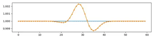

For the leading example, one has to remark that the numpy.roots function is good at finding all the roots fast, but fails to give them to full accuracy. So inserting a Newton step greatly improves the roots and the reconstructed polynomial.
## in IPython, otherwise use print commands for output
p = [1.0]*60
z = np.roots(p)
max(abs(np.polyval(p,z)))
#>>>  1.069574264146017e-12
## Apply a Newton step,
## further steps have random effects with minimal improvements
z = z - np.polyval(p,z)/np.polyval(np.polyder(p),z)
#>>> 4.6250852608698854e-14
## Reconstruct the polynomial
p1 = np.poly(z)
max(abs(p1-1))
#>>> 0.002289390374985656
plt.plot(p,'-+', ms=2); plt.plot(p1,'-o', ms=3); plt.show()
This is with one Newton step. A second one reduces the error by half, a third one increases the error again.
This is from the start better than any of your attempts. One might say that any polynomial that faithfully represents the roots with their errors needs to deviate from the original one in a systematic fashion. It is unlikely that errors, like rounding and cancellation, during the polynomial reconstruction will produce the exact opposite effect to the errors in the roots.
