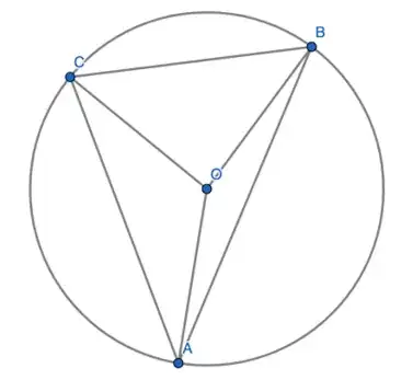

Inscribe a triangle in a circle to produce four areas (three sectors and a triangle). Can the four areas be integer values simultaneously?
The pic
My current processes:
Let radius be $r$, $\angle{AOB}=\alpha$, $\angle{BOC}=\beta$,$\angle{AOC}=\theta$
Then the area of the disk is $A=\pi r^2 \in \mathbb{Z}$
$\therefore r=\sqrt{\dfrac{A}{\pi}}$
$\therefore$ Area of minor segment $AB=\dfrac{1}{2} r^2(\alpha-\sin\alpha) = \dfrac{A}{2\pi} (\alpha-\sin\alpha)\in \mathbb{Z}$
So the problem is congruent to: does an $\alpha$ exists so that $(\alpha-\sin\alpha)$ is divisible by $2\pi$? Three of such $\alpha$ form a set of $(\alpha,\beta,\theta)$ sum to $2\pi$.
Stanley Yang
  • 181
    $\alpha-\sin\alpha$ is a continuous function that takes all values from $-\infty$ to $\infty$ so in particular it takes on values that are multiples of $2\pi$. – Gerry Myerson Nov 27 '21 at 10:15
  • Welcome to MSE! Following up on @GerryMyerson 's comment, $\alpha - \sin \alpha$ is divisible by $\tau$ when $\alpha = \tau, 2\tau, 3\tau \cdots$. However, none of the three angles can have a measure of $\tau$ or greater, as each would have to take up the whole circle! If the answer to the base question is "Yes," then I think you'll need a different path. (I also suspect the answer is "no".) – Eric Snyder Nov 27 '21 at 10:39
    Why would you need $\alpha - \sin \alpha$ be divisible by $2\pi$? The area is $\frac{A}{2\pi} (\alpha - \sin \alpha)$, so we can be less restrictive; we only need $\alpha - \sin \alpha$ to be equal to some rational number times $\pi$. – VTand Nov 27 '21 at 10:45
  • Note that if the four areas have integer values, then so does the circle as a whole (call it $A$), so the radius must be irrational, i.e. $r=\sqrt{\frac{A}{\pi}}$ – Keith Backman Nov 27 '21 at 17:01
  • You want $\alpha - \sin\alpha \in \pi \mathbb{Q}$, $\beta - \sin\beta \in \pi \mathbb{Q}$, and $2\pi-\alpha-\beta - \sin(2\pi-\alpha-\beta) \in \pi \mathbb{Q}$. My guess is that those three conditions are incompatible. – Christophe Leuridan Aug 08 '22 at 11:02
  • @ChristopheLeuridan When you edited the question, you changed "segment $AB$" to "triangle $AOB$", but I think the original version was correct (although it would be more precise to say "minor segment $AB$"). – Dan Aug 09 '22 at 00:17
  • @Dan I corrected back. I did not know the terminology minor segment, major segment. `Segment' AB only usually means the convex hull of ${A,B}$. – Christophe Leuridan Aug 09 '22 at 10:44
