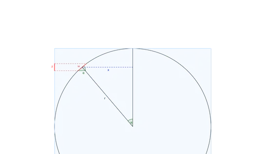

Because a visual solution was requested, I have tried to explain @nsoum 's very correct answer using a diagram.
diagram
Consider a horizontal slice of the cylinder of thickness $z$. Let the length of the arc subtended on the sphere be $w$. From the figure, we can see that we can assume the arc to be small enough to be a straight line segment, if the thickness $z$ is small enough.
$$ \frac{x}{r} = \sin(\alpha) = \frac{z}{w} $$
Also, by using these thicknesses we can calculate area of cylindrical slice and spherical slice:
$$ A_{\textrm{cylinder}} = 2\pi r z $$
$$ A_{\textrm{sphere}} = 2\pi x w $$
But we have proved that $xw = rz$, so $ A_{\textrm{cylinder}} = A_{\textrm{sphere}} $.
This can very easily be extended to equating areas of the spherical cap, by slicing the spherical cap into multiple small slices and adding each one's area. We can say that each slice on the sphere will have area equal to the slice on the cylinder, hence area of the spherical cap becomes $2\pi rh = \pi(h^2+a^2)$
  • Thanks for your answer! I assume that, since that sphere appears to be touching the cylinder at four distinct points, the cross-section (diagram) that you're suggesting is vertical. Am I correct? (By "vertical" I mean the cross-section surface is perpendicular to the flat surface of the cylinder, and passes through the flat surface's center) – Gaurang Tandon Oct 12 '17 at 11:32
  • @GaurangTandon Ahh, yes. Rotate the flat image around the vertical axis (perpendicular to the slice) and you would get the sphere and cylinder. – udiboy1209 Oct 12 '17 at 20:25
