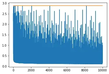

The first parenthesis goes to 1 as the exponents go to infinity and the second one we have by Mertens' third theorem goes to $e^{-\gamma}$ so $f(n)\to e^\gamma\approx 1.78$ if we let k go to infinity. But we don't have to do that, we can take $n=2^a$ in which case $f(n)$ approaches $\frac 2{\log(2)}\approx 2.88$. So far we have that the limit superior is attained in a sub-sequence of n with bounded prime divisors, and with this result, we have that
$$e^\gamma\left(1-\frac 1{2\log(p_k)^2}\right)^{-1}>\left(\log p_k\prod_{h=1}^k1-\frac 1{p_h}\right)^{-1}>e^\gamma\left(1+\frac 1{2\log(p_k)^2}\right)^{-1}$$
which for $p_k\geq 5$ gives $f(n)<2.20$, so you only need to check the $p_k=3$ case to conclude
$$\limsup_{n\to\infty} f(n)=\frac 2{\log(2)}.$$
I plotted $f(n)$ for n up to ten thousand, and you can see the powers of 2 clearly.
