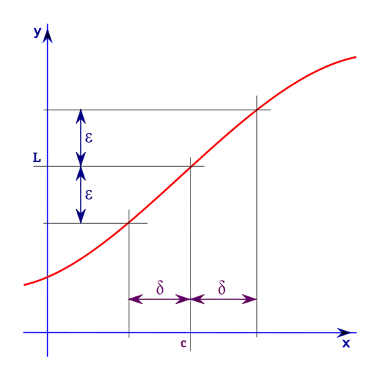

The wikipedia page on the ($\epsilon$, $\delta$)-definition is pretty good. Also, the picture from there may be helpful when you try to visualize $\delta$ and $\epsilon$ as distances.
delta, epsilon limit-definition visualization
