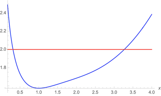

Your function looks like this on the reals:

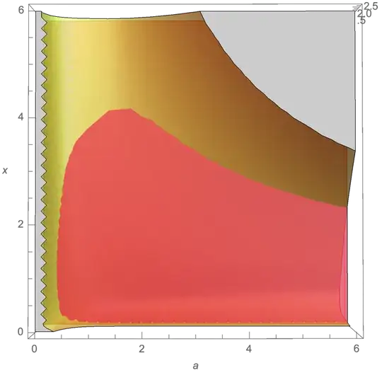

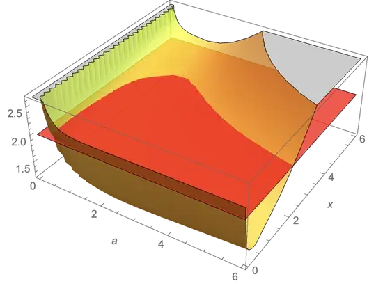

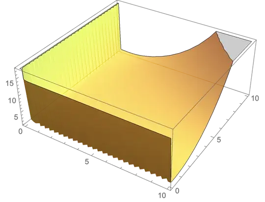

So it is reasonable to expand to small $a$ and $x$ and to examine the curve where the value $2$ is taken. For example $a(x,2)$.
The problem is fundamental because $a^x$ and $x^a$ appear in the composite function. The function is rational and factored in both summands.
Special case is evident $a=x$.
curve
From this visual approach, it is clear together with the fundamentality of the constituents of the composite function that only numerical methods are suitable and understandable to simplify and visualize this inequality.
The result is topping Your work in the very first steps.
An easy path is to approximate around the curve for small values of $a$ and $x$ and for the bigger ones. For small values the curve is for large enough values of the other variable almost a straight line as can be seen in the graph of the function. These approximations are a mathematical art of value to the world.
This is just a motivation to prefer visualization and approximation techniques from numerics and analysis as well as pure analysis.
Nevertheless here some progression:
And viewed from the direction of the surface height.
boundaries where the given surface is 2
This is implicit a clear idea where the equality holds.
It presents crisp clear the boundaries where the given surface is 2. Outside the inequality is true, inside it is false.
A good idea is to approximate or the this boundary curve set.
