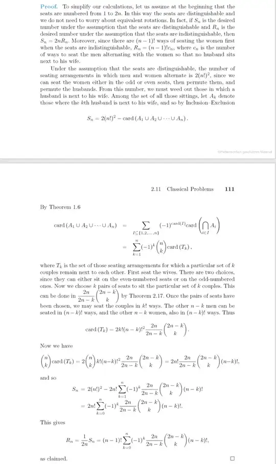

A literature solution can You find in David A. Santos - Probability: An Introduction: An Introduction on page 110.
Santos states:
$R_n=(n-1)!\sum_{k=0}^{n}(-1)^k\frac{2n}{2n-k}\binom{2 n - k}{k}(n-k)!$
for the number of ways of seating n husband with n wives around a circular table, men alternating with woman, so that no husband sits next to his wife.
He presents a proof using a formular that answers your question.
proof
On the other hand taking into account that the seating you are interested in and the one given by the above formula to the total of all possible seatings than you are done.
Santos helps that problem with the formula:
$S_n=2 n R_n$= $2 n (n-1)! \sum_{k=0}^{n}(-1)^k\frac{2n}{2n-k}\binom{2 n - k}{k}(n-k)!$
Excuse for not confirming Your formula and shorting the paragraph of Santos book so that this is not ab initio understandable.
$card$ is short for cardinality so number of elements, distinguishable parts or constituents of a set for Santos.
