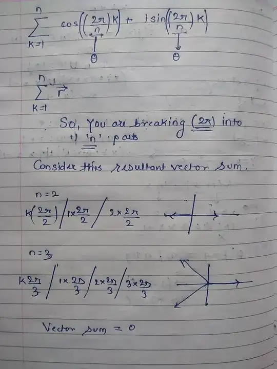

$$S = \sum_{k =1}^n\left[\cos\left(\frac{2k\pi}{n}\right) + i \sin\left(\frac{2k\pi}{n}\right)\right]$$
Consider vectors in complex plane: enter image description here
  • Analytical $$\begin{align*}S &= \sum_{k =1}^n\left[\cos\left(\frac{2k\pi}{n}\right) + i \sin\left(\frac{2k\pi}{n}\right)\right] = \sum_{k =1}^ne^{i\frac {2k\pi}{n}}\\ & =\frac {e^{i(2\pi + \frac {2\pi}{n})}-e^{i(\frac {2\pi}{n})}}{e^\theta-1} =0 \text{ :Numerator = 0}\\ \end{align*}$$
$$\implies \sum _{k=1}^n\:\left(\cos\left(\frac{2\cdot \:k\cdot \pi }{n}\right)-2\:+\:i\cdot \:\sin\left(\frac{2\cdot \:k\cdot \pi }{n}\right)\right) = -2n$$
