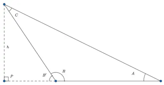

To get a right triangle, consider an obtuse triangle $ABC$ such that $B > 90^\circ$. Here is an illustration.
Extend $\overline{AB}$ to $P$ such that $\overline{AP} \perp \overline{CP}$. We now have a right triangle $APC$ where $\angle APC = 90^\circ$. We also have another right triangle $BPC$ where $\angle BPC = 90^\circ$ and $\angle PBC = 180^\circ - \angle ABC$.
Set $\alpha = \angle CAP$, $\beta = \angle CBP$, and $h = \overline{CP}$. Clearly, $\sin \alpha = h$. We also have $\sin \beta = h$. You can get the rest.
