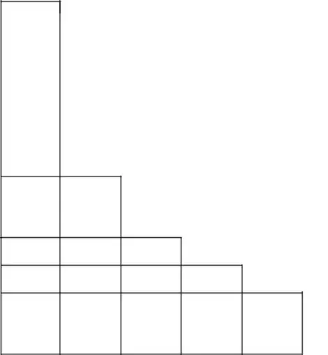

The thread linked by Brian Moehring has a lot of good answers to this (though not hints), but I’d like to add one more that might help provide some insight into why the formula works.
In the diagram below, you can see that $H_5$ is equal to the area of the union of all the rectangles (times some constant). If you use the inclusion exclusion principle to find this area, you can get to the formula your in your question.
