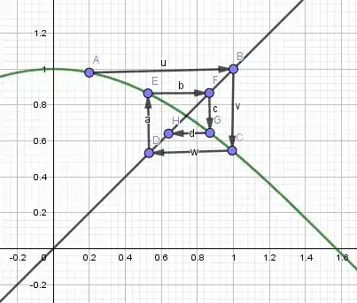

What is happening is that we can see in the repeated series a converging spiraling iterative solution for
$$ y= \cos(x). $$
