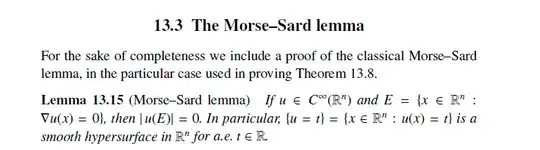

I'm reading Morse-Sard lemma on Francesco Maggi's book, that is the following
Question: Does $|u(E)|=0$ imply that also the measure of the boundary of the set $\{u>t\}$ is zero? In particular, does $|u(E)|=0$ imply $|\partial \{u>t\} |=0$?
I would like to have $|\partial \{u>t\} |=0$ and my professor told me as a hint to use Morse-Sard lemma. However, although I think I understand the statement, I can' t see this implication easily. As I realize it, $|u(E)|=0$ yields that the image of the level sets $\{u=t\}$ has zero measure. Moreover, if $\{u=t\}=\partial \{u>t\}$ (I am not quite sure if this is true), then it follows that the image of the boundary of the sets $\{u>t\}$ has zero measure. But this in turn implies (cf. Boundary of the image is the image of the boundary that the boundary of the image of the sets $\{u>t\}$ has zero measure. And that is not exactly what I needed. What am I missing here?
