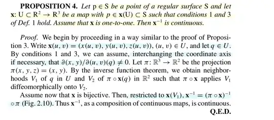

I am reading De Carmo's DG of curves and surfaces. But I have some questions on the proof of "a local parametrization of a regular surface is automatically open", the exact statement is attached below by pic. I am wondering when the condition that S is regular is used in the proof, it seems to me that the proof only uses the conditions of xenter image description here

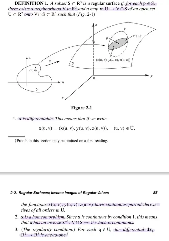

Definition of Regular surface

    Your question makes no sense to me. All the definition is about $\mathbf x$. He applies the inverse function theorem to deduce openness, and this uses precisely the regularity condition. – Ted Shifrin Oct 14 '21 at 16:13
  • @Ted Shifrin, It's not that simple, if this proof was actually correct we could apply it to the figure 8 or a surface analogue of that which can be obtained by extending the figure 8 in the z direction, these are not embeded manifolds in R^2 or R^3 respectively. If this proof was actually correct those examples wouldnt exist. – wannabecapablanca Feb 25 '24 at 15:09
Indeed he never used that $\mathrm{S}$ is a surface, which is why this proof is indeed wrong (or incomplete), a rare oversight by Manfredo. Note that he concluded that $\mathrm{x^{-1}}$ is continuos when restricted to $\mathrm{x(V_1)}$, but we do not know that this set is open, so it isnt possible to conclude from this that $\mathrm{x^{-1}}$ is continuous in the full domain $\mathrm{x(U)}$.
The proof can be amended by actually using the full hypothesys:
Since $\mathrm{S}$ is a surface, we can find a neighborhood $\mathrm{V_0}$ of $\mathrm{p}$ that is the graph of a differentiable function over the projection onto one of the coordinate planes, for simplicity let us assume that $z=f(x,y)$ in this neighborhood (other cases are analogous). From this we see that the projection $\mathrm{\pi:V_0 \to \pi(V_0)}$ is an homeomorphism.
Now for $q=(u,v)\in \mathbf{x}^{-1}(V_0)=:U_0$ we have $\mathbf{x}(u,v)=(x(u,v),y(u,v), f(x(u,v),y(u,v)))$ and by the injectivity of $\mathrm{d\mathbf{x}_q}$ we conclude that $\partial(x,y)/\partial (u,v) \neq 0$.
At this point we proceed like in Manfredo's proof. By the inverse function theorem, we obtain neighborhoods $V_1$ of $q$ in $U_0$ and $V_2$ of $\pi\circ\mathbf{x}(q)$ such that $\pi\circ\mathbf{x}$ applies $V_1$ diffeomorfically onto $V_2$. So, restricted to $\mathbf{x}(V_1)$ we have that $\mathbf{x}^{-1}=(\pi\circ\mathbf{x})^{-1}\circ \pi$ is continuous.
Now the key point is that since $V_2=\pi\circ\mathbf{x}(V_1)$ is open and $\mathbf{x}(V1)\subset V_0$, by the above observation that $\mathrm{\pi:V_0 \to \pi(V_0)}$ is an homeomorphism we conclude that $\mathbf{x}(V1)$ is open, which concludes the proof.
$\square$
In short, the mistake in the original proof can be seem as an implicit misuse of the gluing lemma.
