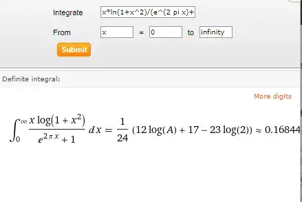

Since I could not find the answer of this integral nowhere, I went to Wolfram Alpha to see whether it matches with it´s solution, but it doesn´t! Nevertheless, I sticked to it, and together with $(3)$ I plugged it´s values in $(2)$.
To get the final answer
$$\begin{aligned} \int_0^\infty \frac{x \ln(1+x^2)}{e^{2 \pi x}+1}\,dx&=\zeta^{\prime}(-1)+\frac12\ln 2 +\frac12 \ln \pi-\frac{3}{4}-2\left(\frac{\ln \pi}{4}-\frac{36}{48}+\frac{35}{48}\ln2+\frac14 \zeta^{\prime}(-1) \right)\\ &=\frac12\zeta^{\prime}(-1)-\frac{23}{24}\ln 2+\frac{18}{24}\\ &=\frac12\left(\frac{1}{12}-\ln A \right)-\frac{23}{24}\ln 2+\frac{18}{24}\\ &=\frac{19}{24}-\frac{23}{24}\ln 2-\frac{\ln A}{2} \qquad \blacksquare \end{aligned} $$
Now, this answer matches with the answer from where I saw the integral, but it does not match Wolfram Alpha´s answer.
The obvious question is: Which one is correct??

  • I would use Abel plana (the $e^{2\pi x}-1$ in the denominator) or check numerically. – Тyma Gaidash Oct 10 '21 at 16:43
  • @TymaGaidash Yeah it came to mind, but I thought that I was already half way ahead using my previous established results. Can you post an answer? – Ricardo770 Oct 10 '21 at 16:45
  • I am more interested in $$\int_0^\infty\frac{x \ln(1+x^2)}{e^{4\pi x}-1},dx=\frac{\ln \pi}{4}-\frac{36}{48}+\frac{35}{48} \ln2+\frac14 \zeta^{\prime}(-1)$$ Since my friend showed already that the final result is correct. – Ricardo770 Oct 10 '21 at 16:47
  • Don’t you mean:$$\int_0^\infty \frac{x\ln(x^2+1)}{e^{\2\pi x}-1}dx$$ like in the title? – Тyma Gaidash Oct 10 '21 at 16:54
  • no, the integral in the title has a plus sign in the numerator, which I just fount out that it´s solution is correct. The one that remains "open" for me is $$\int_0^\infty\frac{x \ln(1+x^2)}{e^{4\pi x}-1},dx=\frac{\ln \pi}{4}-\frac{36}{48}+\frac{35}{48} \ln2+\frac14 \zeta^{\prime}(-1)$$ with a 4 in the exponent in the denominator – Ricardo770 Oct 10 '21 at 17:23
    Does this answer your question? https://math.stackexchange.com/q/2078131/515527 – Zacky Oct 10 '21 at 19:05
  • @Zacky Yeah, thank you! I assume that $$\int_0^\infty\frac{x \ln(1+x^2)}{e^{4\pi x}-1},dx=\frac{\ln \pi}{4}-\frac{36}{48}+\frac{35}{48} \ln2+\frac14 \zeta^{\prime}(-1)$$ is also corect as a consequence. – Ricardo770 Oct 10 '21 at 19:09
