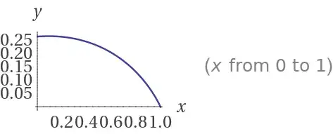

Here is the goal limit again using the central Inverse Regularized Gamma function $Q^{-1}(x,x)$:
$$α\mathop=^\text{def} \lim_{x\to0} Q^{-1}(x,x)=Q^{-1}(0,0)\ne 0$$
Note that Wolfram Alpha says that $Q^{-1}(0,0)=0$, but this is just due to the definition of the function. If you take a look at the graph, the “true” limit clearly is not $0$:
