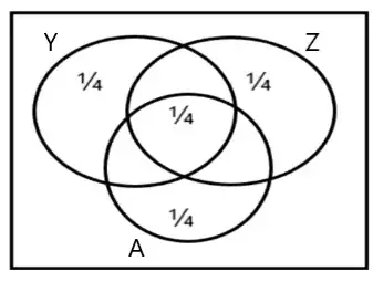

I do not understand how to show that $P(z|a,y)$ is equal to $P(z|a).$
  • $P(Z|A,Y)=P(Z|A)$ is not in general true; e.g., in the following counterexample $$P(Z|A,Y)=1\neq\frac12=P(Z|A).$$
  • However, when $P(A),P(Y),P(Z)\neq0$ and $A,Y,Z$ are mutually-independent events, then the equality is true, since $$P(Z|A,Y)=P(Z|A)\\\iff \frac{P(A,Y,Z)}{P(A,Y)}=\frac{P(A,Z)}{P(A)}\\\iff \frac{P(A)P(Y)P(Z)}{P(A)P(Y)}=\frac{P(A)P(Z)}{P(A)}\\\iff 1=1.$$

  • Thank you for your help. In my case y and z are independent just conditioned on a. I thought it was clear but now I think I should have written it explicitly. Sorry about that. – Jack Oct 10 '21 at 16:52
  • @Jack Yes you did specify that in your Question, and I did take note of that (read my first line). The counterexample that I have given is indeed as per your specification. – ryang Oct 10 '21 at 16:55
