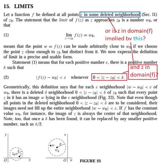

  1. Apparently the above is an equivalent definition of the original definition of $\lim_{z \to z_0}f(z) = L$ which is given as something like...
    For all $\varepsilon > 0$, there exists $\delta > 0$ s.t. $|f(z)-L| < \varepsilon$ whenever $0 < |z-z_0| =$ $\sqrt{(x-x_0)^2+(y-y_0)^2}$ $< \delta$ BUT apparently...
...we don't restrict only to $z=(x,y) \in $ (either $G$ or $U$ or $U \ \setminus \ \{(z_0)\}$. I think $U$.) or something unlike in the case for real multivariable limits? What's going on? How does '$f(z)$' make sense if you don't have $z \in Domain(f)=G$ ? And then maybe this even applies to (1) above.
2.1. UPDATE 1: While I've found a textbook outside our syllabus that talks about $z \in G$ (by $G$ i mean domain of $f$), I've just checked out a textbook in our syllabus (Brown Churchill) that doesn't seem to have $z \in G$. What's going on please?
  • UPDATE 2: the closest i think i've seen to $z \in G$ is that $z$ 'has an image w' but i don't think it necessarily means $z \in G$...or idk...i think 'has an image w' is like assuming rather than implying $z \in G$

    If $z$ is not in the domain of $f$, then what is the truth value of $|f(z) - w_0| < \varepsilon$? – Xander Henderson Oct 06 '21 at 03:24

    They are implicitly assuming that $z$ is in the domain of $f$. – Moishe Kohan Oct 06 '21 at 05:45
    When it says "Let...$f$ be defined at all points $z$ in some deleted neighborhood of $z_0$", that implies (almost by definition) that for sufficiently small $\delta$, all $z$ satisfying $0<|z-z_0|<\delta$ are in the domain of $f$. Does that cover your remaining concern? – Mark S. Oct 06 '21 at 12:05
    Also if $z$ "has an image $w$ (under $f$)", that is exactly the same thing as $z$ being in the domain of $f$ – Mark S. Oct 06 '21 at 12:07
    @MarkS. thank you everyone. this is too weird. but anyhoo i'm fully confident now to ask my instructor about this. – BCLC Oct 06 '21 at 14:18
There is no difference between the "real limit" and the "complex limit". In the definition (2), you must always take $\delta$ sufficiently small so that the punctured disc $0 < |z-z_0| < \delta$ lies entirely in the domain of $f$. This is possible because of the condition (1.1).
