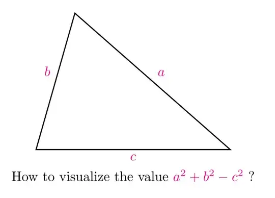

Let $a$, $b$, and $c$ be three lengths of sides of a triangle, that is, $a+b>c$.
How can we visualize the value $a^2+b^2-c^2$ as length of some segment or area, ... constructed from the triangle $ABC$ ?
The value appears in some context, for example Law of Cosine, barycentric coordinate of orthocenter.
I searched, and tried myself for a while, but still have no clues.

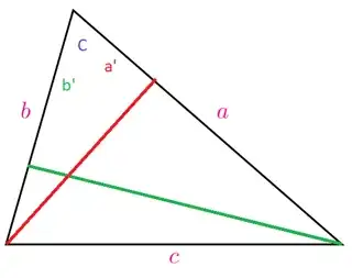

law of cosines
The law of cosines is:
$$a^2+b^2=c^2+2ab\cos C$$
$ab\cos C$ is the dot product of the vectors $\vec a$ and $\vec b$.
It therefore says that:
$$c^2=(a')^2+(b')^2$$
JMP
  • 22,637

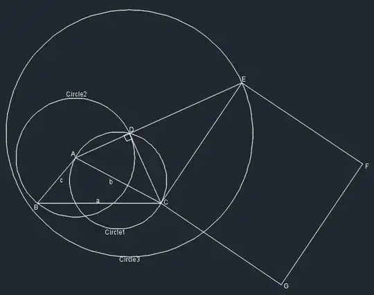

Here is one possible geometric construction:
  1. Draw $Circle1$ with diameter $AC$.
  2. Draw $Circle2$ with center $A$ and radius $c$. Let $Circle2$ intersect $Circle1$ at $D$
  3. Draw $Circle3$ with center $D$ and radius $a$.
  4. Extend $AD$ to meet $Circle3$ at $E$.
  5. Construct square $CEFG$.
As an exercise, calculate the area of the square $CEFG$.
