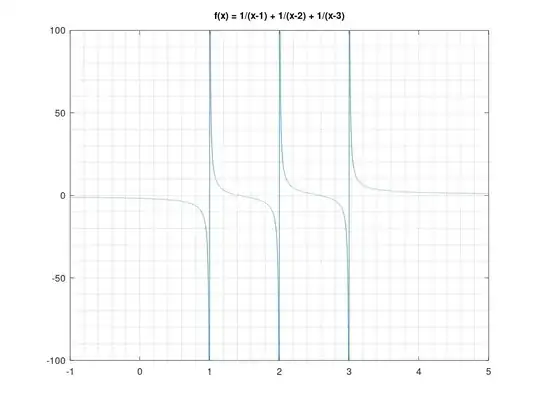

Each $a_i$ produces a hyperbola.
Negative when $x<a_i$ and positive when $x>a_i$.
Sort $a_i$.
A zero will exist between each adjacent pair of $a_i$.
Use a bracketing method between $a_i$ and $a_{i+1}$ to converge on the solution.
Note the "walls" reach $\infty$ and $-\infty$ and the influence from outside adjacent $a_i$ decays rapidly.
Octave/Matlab code
f = @(x) 1./(x-1) + 1./(x-2) + 1./(x-3);
x = [-1:0.001:5];
y = f(x);
# clip y values for plotting
ylimit = 100;
[s idx] = find(y > ylimit);
y(idx) = ylimit;
[s idx] = find(y < -ylimit);
y(idx) = -ylimit;
plot(x,y); grid minor on;
title("f(x) = 1/(x-1) + 1/(x-2) + 1/(x-3)","fontsize",10);
