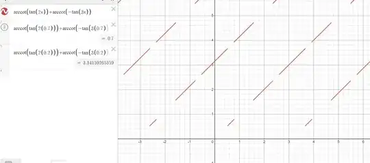

  1. Let us define $\textrm{arccot}$'s principal range to be $(0,\pi).$ Then $$\text{LHS}=\mathrm{arccot}(\tan 2x)+\mathrm{arccot}(-\tan3x)\\ =\frac {\pi}2-\arctan(\tan 2x)+\left(\frac {\pi}2-\arctan(-\tan 3x)\right)\\ =\pi+\arctan(\tan 3x)-\arctan(\tan 2x)\\ =\pi+(3x+m\pi)-(2x+n\pi)\quad\text{for some }m,n \\ =x+k\pi\quad\text{for some }k.$$
    For example, $$x=0.7\implies\text{LHS}=0.7=x=\text{RHS},$$ but $$x=0.2\implies\text{LHS}=0.2+\pi\neq x=\text{RHS}.$$
  2. On the other hand, if we define $\textrm{arccot}$'s principal range to be $\left(-\frac{\pi}2,0\right)\cup\left(0\frac{\pi}2\right],$ LHS still doesn't identically equal $x:$

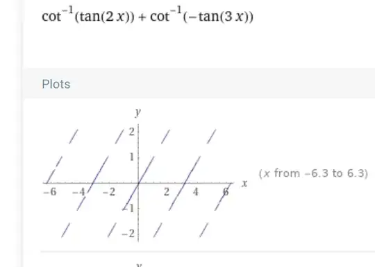

  • I think you missed a thing. My proof only applies when we pick the 1st definition of $arccot$, and when $\frac{\pi}{2}-2x$ and $\frac{\pi}{2}-3x$ are in the 1st quadrant. If these two angles are in the 4th quadrant, my proof doesn't work. If the mentioned angles are in the 4th quadrant, the 2nd line of my proof would become... – tryingtobeastoic Sep 23 '21 at 06:24
  • $$\cot^{-1}(-\cot (\frac{\pi}{2}-2x))-\cot^{-1}(-\cot(\frac{\pi}{2}-3x))$$
    $$-\cot^{-1}(\cot (\frac{\pi}{2}-2x))+\cot^{-1}(\cot(\frac{\pi}{2}-3x))$$
    $$-x$$
    – tryingtobeastoic Sep 23 '21 at 06:27
  • What do you think? – tryingtobeastoic Sep 23 '21 at 06:31
  • But $\cot^{-1}(x)$ is only an odd function according to WolframAlpha's definition. So, how can my 2nd line be accurate according to desmos's definition, where I treated $\cot^{-1}()$ as an odd function? – tryingtobeastoic Sep 23 '21 at 06:56
  • @tryingtobeastoic Ah okay, I just edited the Answer to reflect the fact that if you're using definition two (Desmos's), then yes your proof is simply invalid. Re: you new comments: 1. it's about actual angle values, not quadrants. 2. your original proof actually works under defn one and when $\left(\frac\pi2-2x\right)$ and $\left(\frac\pi2-3x\right)$ are both in, say, -89 to -1 degs (but NOT in, say, 271-359 degs). 3. your new attempt is invalid because (a) it is incorrect to add the minus signs when taking complementary angles, (b) the LHS ought to be still be of the form "$x+k\pi$". – ryang Sep 23 '21 at 07:41
