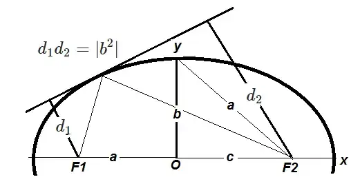

Btw, the product of the length of the perpendiculars drawn from the focal points of an ellipse $(\pm c,0)$ to the tangent straight line $bx\cos\theta+ay\sin\theta-ab=0$ is $b^2$ when $a^2=b^2+c^2$.
Can be also derived from Newton's ellipse canonical form.
