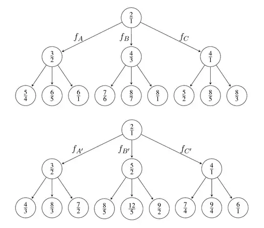

You may already know where I'm going with this. After some trial-and-error, I indeed managed to find a set of transformations that accomplish this; in fact, I found two sets of transformations. The first set looks like this:
$$ f_A\left(\frac{m}{n}\right) = \frac{m+n}{2n},\qquad f_B\left(\frac{m}{n}\right) = \frac{2m}{m+n},\qquad f_C\left(\frac{m}{n}\right) = \frac{2m}{m-n}, $$
or in matrix form:
$$ \begin{pmatrix} m_A\\ n_A \end{pmatrix} = \begin{pmatrix} 1 & 1\\ 0 & 2 \end{pmatrix} \begin{pmatrix} m\\ n \end{pmatrix},\quad % \begin{pmatrix} m_B\\ n_B \end{pmatrix} = \begin{pmatrix} 2 & 0\\ 1 & 1 \end{pmatrix} \begin{pmatrix} m\\ n \end{pmatrix},\quad % \begin{pmatrix} m_C\\ n_C \end{pmatrix} = \begin{pmatrix} 2 & 0\\ 1 & -1 \end{pmatrix} \begin{pmatrix} m\\ n \end{pmatrix}. $$
The second set of transformations is $$ f_{A'}\left(\frac{m}{n}\right) = \frac{2m-n}{m},\qquad f_{B'}\left(\frac{m}{n}\right) = \frac{2m+n}{m},\qquad f_{C'}\left(\frac{m}{n}\right) = \frac{m+2n}{n}, $$ or $$ \begin{pmatrix} m_{A'}\\ n_{A'} \end{pmatrix} = \begin{pmatrix} 2 & -1\\ 1 & 0 \end{pmatrix} \begin{pmatrix} m\\ n \end{pmatrix},\quad % \begin{pmatrix} m_{B'}\\ n_{B'} \end{pmatrix} = \begin{pmatrix} 2 & 1\\ 1 & 0 \end{pmatrix} \begin{pmatrix} m\\ n \end{pmatrix},\quad % \begin{pmatrix} m_{C'}\\ n_{C'} \end{pmatrix} = \begin{pmatrix} 1 & 2\\ 0 & 1 \end{pmatrix} \begin{pmatrix} m\\ n \end{pmatrix}. $$ Starting with $2/1$, we obtain the two trees
rational trees
It is straightforward to prove that each tree indeed enumerates all rationals with the properties 1-3, without duplicates (I'll leave that as an exercise).
Unlike the binary Calkin–Wilf and Stern–Brocot trees, these trees are ternary. My question is: is there a deeper reason for this? Why do these transformations come in sets of three? Can it be proven that these two are the only possible sets of transformations?
