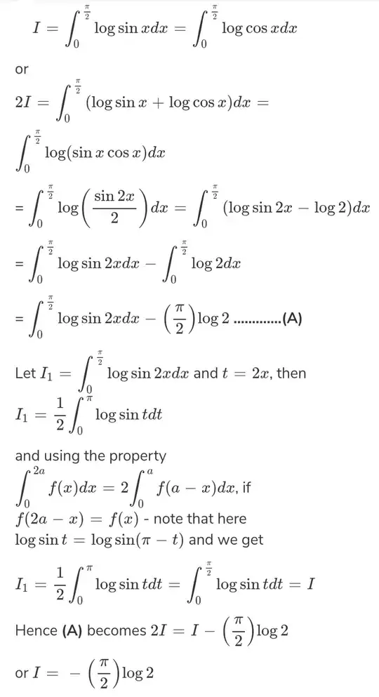

Let $$\int_0^{\infty} \frac{\log(1+x^2)}{1+x^2}dx= J$$.
Substituting $x=tan(\theta)$,
$$J=-2\int_0^{\frac{π}{2}} \log{\cos{\theta}}d{\theta}$$.
Hence, $$J=π\log 2$$.
Explanation of integral here
