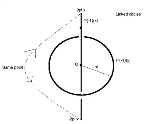

Consider in particular $f^{-1}(x)$. This is all points in $S^3$ which map to a $T_\theta$. That is precisely the line through the origin and $x$. Note this line is actually a circle, as the boundary points of $B$ are identified. In other words $2\pi x=-2\pi x$ in $S^3$.
Now consider the fiber $F_y$ where $y$ is the point in $S^2$ opposite $x$. The fiber above $y$ in $SO(3)$ is all $\pi$ radian rotations about an axis perpendicular to $x$. These are precisely the rotations taking $x\mapsto y$.
Thus $f^{-1}(y)$ is the circle about the origin of radius $\pi$, perpendicular to $x$. Thus we can see that $f^{-1}(x)$ and $f^{-1}(y)$ form a pair of linked circles in $S^3$.
Note that for any points $z\neq w\in S^2$ there are paths in $S^2$ from $x$ to $z$ and from $y$ to $w$ which do not cross. Following these paths gives us isotropies of the fibers from $f^{-1}(x) \to f^{-1}(z)$ and $f^{-1}(y) \to f^{-1}(w)$, which also do not cross. Thus any pair of fibers $f^{-1}(z)$ and $f^{-1}(w)$ will be linked in the same way as in the picture above.
