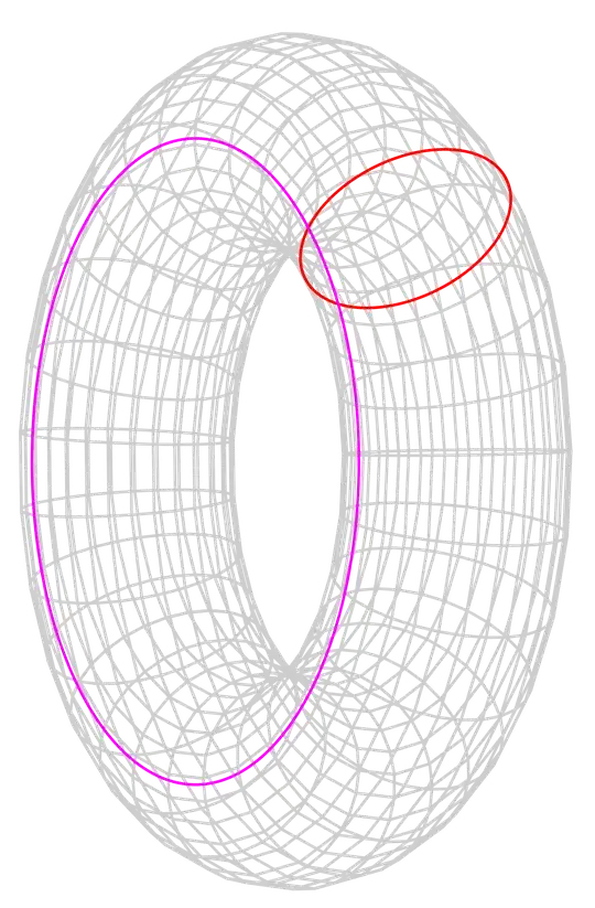

Similary it is said that the circle $S^1$ has a $1$-dimensional hole. But isn't this hole regarded from common sense $2$-dimensional? Essentially this "hole" is the removed inner of a $2$-disc $D$ where $S^1 = \partial D$. Can somebody clarify the 'logic' behind the "dimension" of the holes in this setting.
Even more confusing is the notation of a hole for a torus $T$. According to the 'logic' above a $k$-dimensional hole of a $k$-simensional "surface" is the 'removed inner mass' which as observed in examples before seemingly should be always contractible to a point.
But in case of torus the $1$-hole is not even contractible, since it is homotopic to $S^1$.
That's confusing. Is it possible at least just for these two quite simple examples to precisely define what a $k$-hole is?

  • I think there is still a problem with this definition, let's look at torus here: https://en.wikipedia.org/wiki/Homology_(mathematics)#Informal_examples It's naturally that the red and the blue circles, which of course are $1$-cycles, may be regarded as $1$-dim holes. But their union is clearly also a $1$-cycle, which clearly not bound a $D^2$. But nevertheless the union of red and blue circles is not a "$1$-dim hole" in our intuition. – user267839 Sep 04 '21 at 21:18

Now for a torus. We have two $1$-dimensional holes -- that is, circles which don't bound disks (do you see what they are?). We also have a $2$-dimensional hole. That is, a $2$-dimensional surface (the torus itself) which isn't the boundary of a $3$-dimensional surface. This is the "air" inside the inner tube.

    I'm not sure if this a reasonable definition. Let's look agin at torus. As you said there are two circles (red and blue in the picture here: https://en.wikipedia.org/wiki/Homology_(mathematics)#Informal_examples)

  • Acording to your definition each of this circles can be called a $1$-dimensional hole. That's fine and corresponds to my intuition of a $1$-hole. But according to your definition the union of these two circles - which is also a $1$-dimensional subcomplex of the torus which is not a boundary of a $2$-d cubcomplex - would be also a "$1$-dimensional hole", or not? But that's not what we want. – user267839 Sep 04 '21 at 20:52
  • That's fair, I was slightly sloppy. Remember that the homology groups are groups. The (red and blue) holes that you're expecting are there (and are generators for this group) but the union of those two circles is also an element of the homology group -- it's exactly the sum of the red and blue holes (in the group theoretic sense). If you like, the number "basic" $n$-holes is the rank of the $n$th homology group, known to its friend as the $n$th betti number. – Chris Grossack Sep 04 '21 at 20:56

  • You should think that the blue and red circles form a basis for $H_1(T)$ (more correctly, their corresponding cycles). There are many bases, but the rank of the homology group counts the holes. This is unsatisfying, but a cost of doing business. Finding "satisfying" cycle representatives for a basis in homology in general (e.g. in the computational context) is the subject of ongoing research. –  Sep 04 '21 at 23:18

  • For concreteness, consider the $2$-torus $T$.
  • Any circle $S^1$ inside of $T$ represents a $1$-cycle, but, in general, this circle may or may not be "filled in."
    • If you pick a small circle lying on the surface of the torus, then the circle is "filled in" in the sense that it bounds a $2$-disk. In this case, the circle (a cycle) happens to be a boundary (of a $2$-disk), so this represents a trivial homology class.
    • If you pick a circle which goes around the inner tube (as @HallaSurvivor called it), then you have a $1$-cycle which cannot be filled in. That means the circle is not the boundary of any $2$-disk in $T$. This cycle therefore represents a non-trivial homology class in $H_1(T)$.

  • About your last sentence: Consider the torus. Then here https://en.wikipedia.org/wiki/Homology_(mathematics)#Informal_examples the blue and the red circle correspond to a $1$-hole. But the union of the red and blue circle is a $1$-cycle too, but not corresponds to a $1$-hole. – user267839 Sep 04 '21 at 22:08
