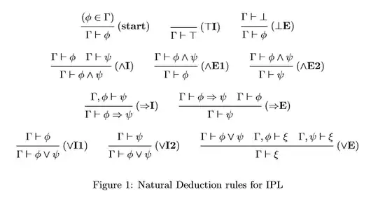

To give a conveniently concise answer to this, let's have a look at the following very formal but precise way to specify the deduction rules of intuitionistic propositional logic (IPL):
To give a very quick explanation: Every rule states at the top of the line what you need to show in order to conclude what is below the line. Presenting rules in this way and building proofs with them is know as the system of natural deduction and if you want to know more about this, I can really recommend the write-up on the Lean prover page as a starting point.
So what is now the difference between IPL and classical propositional logic (CPL)? It's simply that CPL has one more rule compared to IPL, namely $\mathsf{DNE}$: $$ \frac{\Gamma \vdash \neg \neg \phi}{\Gamma \vdash \phi} $$ And that's it! The difference is the presence or absence of one single rule and this carries over to the respective predicate logic. This has major consequences to how much information a proof contains, as in classical logic we can give proofs that are themselves non-informative. This is not possible - by design - in intuitionistic logic. And again: all it takes is to leave out one rule.
It can be shown that rule we left out ($\mathsf{DNE}$) cannot be derived from the rules that are still present, but this requires some more work in the form of e.g. a semantics for the logic.
Overall, from the natural deduction viewpoint, this means $\mathsf{LEM}$ is a valid principle in classical logic, as it is build in from the start. Its validity can be further justified by looking at the classical semantics, showing that CPL constitutes a sound logical system. IPL can neither prove nor disprove $\mathsf{LEM}$/$\mathsf{DNE}$, it simply opts to not assume it, and as a benefit from this, intuitionistic proofs are always informative.
