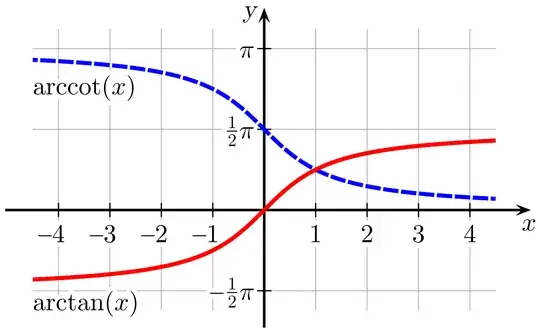

The inverse function for $\cot(x)$ is denoted as $\operatorname{acot}(x)$ or $\operatorname{arccot}(x)$ or $\cot^{-1}(x)$ which is a particular restriction of $\cot(x)$ from $(0,\pi) \to \mathbb R$.
enter image description here (credit Wikipedia)
An evaluation with wolfram returns
$$\operatorname{acot}\left(\frac \pi 4\right)\approx 0.90502\,(\text{radians})\quad(=51.85°) $$
