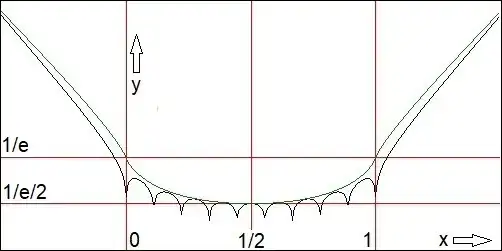

A graph says more than a thousand words:
The interval $\,[0,1]\,$ and the minimum of $\,F_\infty\,$ are delimited with red lines. A sample function $\,F_N(x)\,$ for $\,N=9\,$ is displayed in black. The limit function $\,F_\infty(x)\,$ is displayed in green. Numerically it is suggested that the black curves $\,F_N\,$ converge to the green curve $\,F_\infty\,$.
With exception, though, of the function values $\,f_N(k/N)\,$; all of these must be zero from the start. But in the limit this would mean that $\,F_\infty(x)\,$ is zero as well as non-zero at the whole $\,[0,1]\,$ interval. Which is of course impossible.
What is a sensible way out of this dilemma?

  • I'm not sure since I don't have a proof, but I think the answer to your dilemma is simple: the product doesn't converge. – jjagmath Aug 24 '21 at 18:10
    A little tantrum: I am a weak red-green colorblind and it is almost impossible to distinguish the colors used in the figure. (I can perceive that those curves have different colors, but can't tell which one is red or green.) – Sangchul Lee Aug 24 '21 at 19:09
  • @SangchulLee: Oh well, you’re not too colorblind to formulate a decent (+1) answer :) – Han de Bruijn Aug 24 '21 at 20:17

The answer is simple: $F_N(x)$ does not converge to $\exp\left(\int_{0}^{1}\log|x-t|\,\mathrm{d}t\right)$ when $x \in \mathbb{Q}\cap[0,1]$.
Let $x \in [0, 1]$. Then it is not hard to check that
$$ \log F_N(x) = \int_{0}^{1} \log|x-t| \, \mathrm{d}t + \frac{1}{N} \log\operatorname{dist}\biggl( x, \frac{1}{N}\{0,1,\ldots,N\} \biggr) + \mathcal{O}\biggl( \frac{\log N}{N} \biggr). $$
So, $\log F_N(x)$ converges to $\int_{0}^{1} \log|x-t| \, \mathrm{d}t$ if and only if
$$ \liminf_{N\to\infty} \frac{1}{N} \log\operatorname{dist}\biggl( x, \frac{1}{N}\{0,1,\ldots,N\} \biggr) = 0. $$
Equivalently, $\log F_N(x)$ does not converge to $\int_{0}^{1} \log|x-t| \, \mathrm{d}t$ if and only if
$$ x \in A := \bigcap_{p=1}^{\infty}\bigcap_{N=1}^{\infty}\bigcup_{n=N}^{\infty}\bigcup_{k=0}^{n} \biggl( \frac{k}{n}-e^{-n/p}, \frac{k}{n}+e^{-n/p}\biggr). $$
It is also interesting to note that $A$ is a $G_{\delta}$-set containing $\mathbb{Q}\cap[0,1]$, hence is uncountable.
