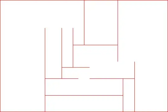

It's something. But I had doubts if it could produce ALL possible splits. So I took a look at the games, and sure enough, the first level I clicked already had a split which cannot be produced with the above algorithm:
Split
This also gave me inspiration to produce this split, which I think is a minimal example of another split that cannot be produced by the above algorithm:

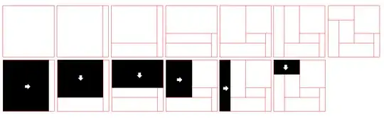

There is an algorithm: with any partition into rectangles, starting at the top-left corner of the big rectangle, take all or part of the top edge or left edge and push it into the big rectangle to give a new partition with an additional small rectangle, constrained by the existing small rectangles.
Here is how to construct what you called your minimal example using this algorithm.
This works because if you consider any possible partition into rectangles, you can always remove the top-left small rectangle by doing this step backwards. Since you start with a finite number of small rectangles and you keep removing one, you must end up with the original big rectangle.

  • Whoa! Good one! Now I need to figure out how to make sure every possible arrangement is equally possible (or thereabouts), and to make sure it produces playable grids... but those are separate questions. Have a checkmark! :) – Vilx- Aug 24 '21 at 11:23
  • What if the top left triangle is adjacent to two or more rectangles along both its internal edges? For example your final arrangement but rotated 90 anticlockwise. – Jaap Scherphuis Aug 25 '21 at 15:40
  • @JaapScherphuis In that pattern the top-right rectangle (unrotated) is adjacent to two rectangles on its bottom edge, but $1.5$ rectangles on its left edge. Only integers work for this algorithm so the choice would be forced, and at least one edge must have integer rectangles to avoid overlapping rectangles. It is possible to have both as integers involving a $+$ intersection inside the big rectangle, in which case there may be more than one way to construct the partition - imagine a big square made up of four small squares. – Henry Aug 25 '21 at 17:55
  • I don't really follow what you mean. But basically I question the assertion "This works because if you consider any possible partition into rectangles, you can always remove the top-left small rectangle by doing this step backwards." – Jaap Scherphuis Aug 25 '21 at 18:09
    @JaapScherphuis - I am saying that the small rectangle in the the top-left (there must be one) must be attached on its right to the full left sides of other small rectangles or be attached on its bottom side to the full top sides of other small rectangles. So it can be eliminated, with a leftward extension of the other small rectangles in the former case and with an upward extension of the other small rectangles in the latter case. In the process of construction this is reversed, and it is introduced squeezing small rectangles rightwards in the former case, downwards in the latter case – Henry Aug 26 '21 at 01:30
