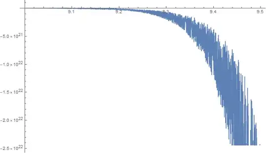

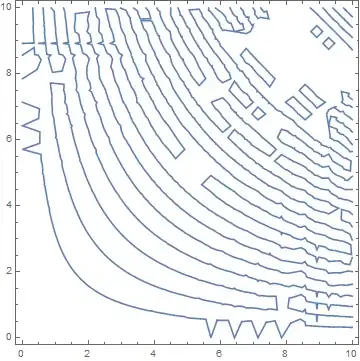

  • @Zacky: I ran Mathematica and used the wrong range in the first trial. After changing it to the correct one I obtained a more compact term that involves the Meijer G function. In order to get a rough idea how these functions look like, I added some plots (the answer section allowed me to add figures). I hope these may help and support the investigations. –  Aug 22 '21 at 11:06

The searched integral function involves the Meijer G function and it is given by:
$\int_{0}^{\infty} \frac{\sin(xy)}{1+x^2+y^2}dx=\frac{\sqrt{\pi } G_{1,3}^{2,1}\left(\frac{1}{4} \left(y^4+y^2\right)| \begin{array}{c} 1 \\ 1,1,\frac{1}{2} \\ \end{array} \right)}{y^3+y}$
where the following condition must be met:
$\Im(y)\leq 0\land \left(\Im\left(\sqrt{-y^2-1}\right)\neq 0\lor \left(\Re(y)=0\land \Re\left(y^2\right)+1>0\land \Im(y)+1>0\land \Re\left(\sqrt{-y^2-1}\right)\leq 0\right)\right)$
The plot of original function for $x,y\in[0,10]$ is:
and the plot of the resulting integrated function for $y\in[9,9.5]$ is:
