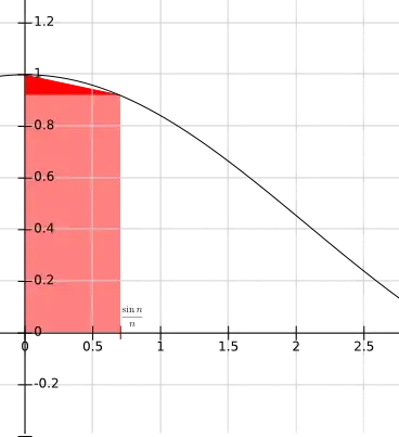

$\frac{\sin x}{x}$ is decreasing and convex on $[0, 1]$:
sin(x) / x decreasing and convex
So we can estimate the integral from below as the square of highlighted region: $$ \int_0^{\frac{\sin n}{n}} \frac{\sin x}{x}\,dx \ge \left.\frac{\sin x}{x}\right|_{x=\frac{|\sin n|}{n}}\cdot\frac{|\sin n|}{n} + \frac{1}{2}\cdot\frac{|\sin n|}{n}\cdot\left(1 - \left.\frac{\sin x}{x}\right|_{x = \frac{\sin n}{n}}\right) = $$ $$ = \frac{1}{2}\sin\left(\frac{|\sin n|}{n}\right) + \frac{1}{2}\frac{|\sin n|}{n}. $$ Thus, including my remark on Norbert's answer, your series converges if and only if $$\sum_{n=1}^{\infty}\frac{|\sin n|}{n}$$ converges.
