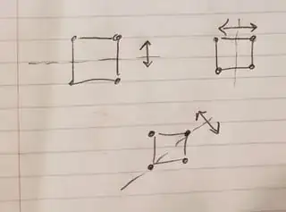

For a simple example, consider the following $3$ subgroups inside $D_8$:
three flippies in a square
The two copies of $\mathbb{Z}/2$ given by the flips in the top row are conjugate. They're really "the same flip", up to a rotation of the square. Contrast this with the copy of $\mathbb{Z}/2$ given by the diagonal flip underneath. Even though this is the same subgroup up to isomorphism, it arises in an entirely different way from those in the top row.
