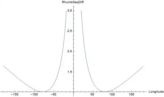

RhumbSeqDiff[Phi1_, Lambda1_] :=
  Norm[RhumbSeq[Phi1, Lambda1] - {Phi1, Lambda1}];
I decided to see if the function would work if we select the solutions on the South Pole. Using some simple trigonometry, one finds that the latitudes of these solutions (in degrees) are $${\varphi_n}^{\circ}=-\frac{180}{\pi}\arccos\left(\frac{1}{2\pi R n}\right)+\frac{360}{2 \pi R},\quad \forall n\in \mathbb{N}.$$ I tested if RhumbSeqDiff[-(180/Pi)*ArcCos[1/(2*R*Pi)] + 360/(2*R*Pi), lambda] would return $0$ for any lambda, which is what happened - as expected. However, when I try to plot the function I get some weird results. For instance, if I plot the function along the $n=1$ solution using Plot[RhumbSeqDiff[-(180/Pi)*ArcCos[1/(2*R*Pi)] + 360/(2*R*Pi), x], {x, -180, 180}], I get dependence on $\lambda$ and the function is nonzero everywhere:
My idea was that I could use ContourPlot or RegionPlot to find the locus (such as ContourPlot[RhumbSeqDiff[y,x]==0, {x, -180, 180},{y, -90, 90}]), but with this bug I am unable to do so. Perhaps this problem is rectifiable?
