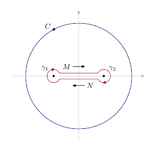

Can I evaluate $\int_{-1}^1\sqrt{1-x^2}dx=\pi/2$ by using complex integration? Using the dog bone contour it seems perfectly possible. But the function has no residue... Isn't the integral around the closed contour equal to zero?
(The dog bone contour is in red below) enter image description here

  • @user2628206 I don't understand what you mean. I am using the usual dog bone that goes around the branch line, which is between -1 and 1. Isn't the function holomorphic outside of that? – thedude Aug 06 '21 at 13:07
  • I don't know what the usual dog bone is, so I can't comment further, but It seems like you have taken branches into account and thus holomorphicity isn't the problem. Consider adding details about the curves you have set up, and then users can better understand your analysis and spot any potential problems in reasoning . – user2628206 Aug 06 '21 at 13:29
  • @user2628206 I have included an image of the dog bone contour in the question – thedude Aug 06 '21 at 13:34
Since the integrand, $f(z)=\sqrt{1-z^2}$, is not analytic inside the dog bone contour, $C_{DB}=M+\gamma_2+N+\gamma_1$, Cauchy's integral theorem does not apply. However, inasmuch outside of $C_{DB}$ , $\sqrt{1-z^2}$ is indeed analytic, then we can assert that for any $R>1$
$$\begin{align} \oint_{C_{DB}} \sqrt{1-z^2}\,dz&=-\oint_{|z|=R}\sqrt{1-z^2}\,dz\tag1 \end{align}$$
where the negative sign that multiplies the integral on the right-hand side of $(1)$ is a consequence of the orientation.

You can Cauchy's theorem to show that the integral over the dog bone contour is equal to the integral over the outer circle, and you can use the definition of the former integral to get that the integral over the dog bone contour is twice the integral in question. But this doesn't really help you evaluate the integral. The basic issue is that the functions in question don't have poles anywhere, so the residue theorem can't be used to give a numerical answer.
