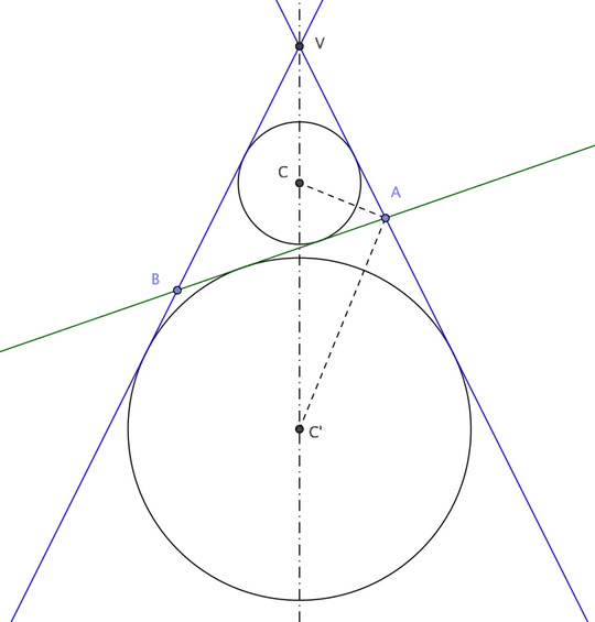

I have been studying conic sections recently, and I came across the proof on how the algebraic definition of conic sections can be derived using Dandelin spheres.
I understood the proof for elipses, parabolas and hyperbolas. Where i am struggling is, that how can we be sure that a Dandelin sphere always exists. Is there a mathematical proof which ensures that a Dandelin sphere will always exist for all possible conics ?
I thought of proving this by proving that there always exists a unique sphere which passes through a circle and a point lying outside of the circle. But this doesn’t ensure that the sphere will be tangent along the circle to the cone and that it will be tangent to the plane (or does it ? If so, then I am unable to see it.)
Can you please help me out ?
Thanks in advance.

Given a cone and an intersecting plane $\alpha$, consider the plane $\beta$ passing through the axis of the cone and perpendicular to $\alpha$. That plane cuts $\alpha$ at a line $AB$ and the cone at a couple of lines intersecting at the vertex $V$ of the cone ($VA$ and $VB$ in figure below, illustrating the case of an ellipse).
The axis of the cone is the bisector of $\angle AVB$. Construct then the bisectors of $\angle VAB$ and of its adjacent angle, intersecting the axis at $C$ and $C'$. As the bisector of an angle is the locus of points equidistant from the sides, points $C$ and $C'$ have the same distance from lines $VA$, $VB$, $AB$. Hence they are the centres of two circles tangent to those lines.
If you now rotate those circles about the axis of the cone, you'll get the desired Dandelin's spheres. I made the construction for the case of an ellipse, but the reasoning for a parabola or hyperbola is analogous.
