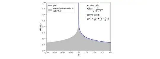

import numpy as np
from scipy.special import ellipk
fig, ax = plt.subplots(1, figsize=(12,6))
#Numerical Convolution Arcsine R=np.linspace(-0.9999999,0.9999999,100000) dR=R[1]-R[0] arcsin=1/(np.pi(np.sqrt(1-R2))) pdf=np.convolve(arcsin,arcsin,mode='same') size=np.size(pdf) af=dRnp.sum(pdf) f2=pdf/af f1=np.full(np.size(pdf),0) ax.fill_between(R[::10], f1[::10], f2[::10],color='black',zorder=-10,alpha=0.25,label="convolution numerical:\n$f(R)*f(R)$",interpolate=True,linewidth=0)
#Formula convolution with Elliptic Integral R1=np.linspace(0.00000001,1,1000) f3b=ellipk(1-4/(R1*2)) f3b=1/(np.piR1)*f3b ax.plot(R1,f3b,label=r"$g(R)$",color='blue',linewidth=1.5)
text="arcsine pdf: \n" + r"$f(R)= \dfrac{1}{\pi \sqrt{1-R^2}}$" ax.text(0.25,1.7,text,fontsize=14)
text="convolution: \n" + r"$g(R)= \dfrac{1}{\pi R} \cdot K \left( 1- \dfrac{4}{R^{2}} \right)$" ax.text(0.25,1.3,text,fontsize=14)
ax.set_xlabel("$R$",fontsize=14) ax.set_ylabel("density",fontsize=14) ax.legend(loc="upper left",fontsize=12) ax.set_xlim([-1, 1]) ax.set_ylim([0,2])
plt.show()

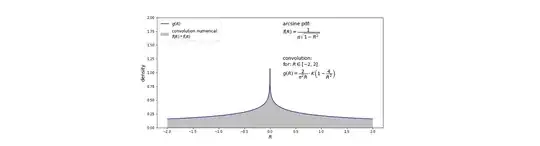

So the convolution of two $\arcsin$ distributions with $R \in[-1,1]$:
$$f(R)=\frac{1}{\pi \sqrt{1-R^2}}$$ $$f(R)*f(R)=\left\lvert \dfrac{2}{\pi^{2} R} \cdot K \left( 1- \dfrac{4}{R^{2}} \right) \right\rvert $$
The numerical convolution and formula found (gray area) are plotted below in the correct range $R \in [-2,2]$: enter image description here
