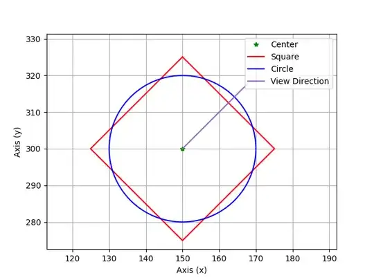

Given the four corners $(x, y)$ of a square, the center $(x, y)$, and a starting direction (ex: $45^\circ$) around a $360^\circ$ rotation ($0^\circ/360^\circ$ at the top), how do you find out the intercept on the perimeter as the direction is incrementally stepped?
What I'm basically doing is taking a circle of radius $(r)$, determining it's area $(A)$, converting that to length $(L)$ of the sides of the square, and then determining the corners $(x, y)$ given the starting center point and the above described direction. This allows for the square to rotate it's starting position depending on the direction. I used the equations below to determine the corners (assuming $(x, y)$ is the center of the circle):

Example Diagram

  • I added a diagram showing what I'm talking about. The circle and the square have the same area, and I'm wondering how to figure out at what point $(x, y)$ that the purple line crosses the perimeter as we rotate it around (it will always be anchored in the center). – Xagen Jul 30 '21 at 01:30
  • I'm guessing that the only way is to make a right triangle with the midpoint of that side and then use it to find the length of the side on the perimeter and from that the coordinates on the other end. However, I was hoping for something less involved/more elegant. – Xagen Jul 30 '21 at 01:42
