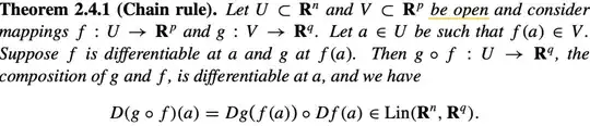

In Kolk's Multidimensional Real Analysis I: Differentiation
He gave a very detailed version of Chain rule at some point $a$ as follows:

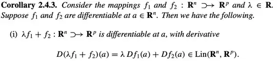

Now I want to use Chain rule to prove the following corollary:
Here is my proof:
  1. Step1:
    We define $f: \mathbf{R}^n \rightarrow \mathbf{R}^p \times \mathbf{R}^p $ by $f(x)= (f_1(x),f_2(x))$. We know $f$ is differentiable at $a$, while $Df (a)h = (Df_1(a)h, Df_2(a)h), \text{for all} \, a, h \, \in R^n$ We define $g: \mathbf{R}^p \times \mathbf{R}^p \rightarrow \mathbf{R}^p$ by $g(y_1,y_2) = \lambda y_1+y_2$. So we have $g\circ f= \lambda f_1+f_2$.
  2. Step2:
\begin{align*} D(\lambda f_1+f_2)(a) &= D(g\circ f)(a) \\ &=Dg(f_1(a),f_2(a)) \circ Df(a) \text{............(have used Chain rule here)} \\ &=g \circ Df(a) \text{............(because we fortuanately know $g$ is linear, so g is its own derivative everywhere)} \end{align*}
  1. Step3:
    We are still not done here since we want to prove two linear functions are equal. So we have to introduce another vector, say $h \in R^n$, to see if they are equal for any $h$. Thus we use the above equation with $h$: $g \circ Df(a) h = g(Df_1(a)h, Df_2(a)h) = \lambda Df_1(a)h + Df_2(a)h = (\lambda Df_1(a) + Df_2(a))(h)$. Proof is done
I have two questions:
  1. Is my proof strictly/rigorously correct?
  2. Is it necessary to introduce this $h$ to prove "two derivatives are equal"?
  3. Can my proof be further simplified? Why the author just say it's obvious, which seems to me quite complicated.

  1. Yes, your proof is right (I just checked my copy of Duistermaat and Kolk and indeed you didn't invoke anything not already proven).
  2. Sure, one can introduce the vector $h$ to see that the evaluation of both sides is the same. But to me this seems 'obvious'. Indeed I could reverse the question and ask you why in step 1 you did not verify explicitly (by plugging in an arbitrary $x$) that $g\circ f = \lambda f_1+f_2$ (I'm guessing you didn't do this because it seemed obvious enough because the functions $f$ and $g$ were literally constructed to make this equation true).
  3. I'm not sure if this proof can be simplified, but the authors probably said it is obvious because all you're doing is applying the chain rule to carefully chosen functions.
So, if it was me, I would have just written the following for a proof:
(Define $f,g$ as you have done). Then, $\lambda f_1+f_2=g\circ f$, so \begin{align} D(\lambda f_1+f_2)_a&=D(g\circ f)_a\\ &=Dg_{f(a)}\circ Df_a\tag{chain rule}\\ &=g\circ Df_a\tag{$g$ is linear}\\ &=g\circ ((Df_1)_a,(Df_2)_a)\\ &=\lambda (Df_1)_a+(Df_2)_a \end{align}
So, the only theorems being invoked are the chain rule and that linear maps have derivatives equal to themselves.
Of course, having now proven this theorem as a consequence of the chain rule, you should also prove it directly from the definition: i.e prove (using triangle inequality) that \begin{align} \frac{\bigg\|\,\,\,(\lambda f_1+f_2)(a+h) - (\lambda f_1+f_2)(a) - [\lambda (Df_1)_a(h)+(Df_2)_a(h)]\,\,\,\,\bigg\|}{\|h\|}\to 0 \end{align} as $h\to 0$.
