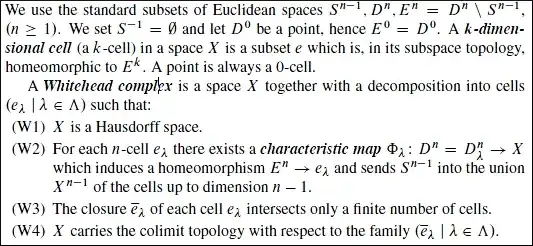

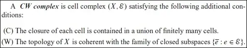

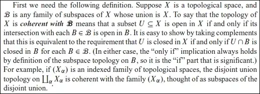

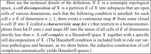

1) DEFINITIONS From Introduction to Topological Manifolds (J. M. Lee) enter image description here enter image description here enter image description here
and from Algebraic Topology (T. tom Dieck): enter image description here enter image description here
These definitions are so complicated, that I can't really see what's going on.

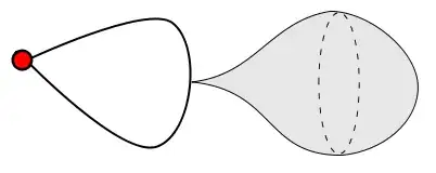

2) MY PROBLEM: But shouldn't there be some condition on $f_\lambda$? For example, if we have a graph ($1$-dimensional complex) consisting of a single vertex and a single edge. Then when we are attaching $\mathbb{B^2}$, we can set $f$ to map the whole $S^1$ to a single point on the edge, that isn't the vertex. Thus we get a very weird space: enter image description here
Shouldn't $f$ go along each loop/edge in $X^{(1)}$ integer many times and not stop in the middle? Also, how do we prevent $f$ from oscillating infninitely? For example, if $X^{(1)}$ contains two edges $a,b\subseteq\{0\}\times\mathbb{R}\subseteq\mathbb{R}^2$ with $a\cap b=\{(0,0)\}$, then $f(x)=(0,x^2\sin(1/x))$ can go infinitely many times into $a$ and $b$.

  • @Mariano Yes, I see that, but what part of the definition of a CW-complex prevents cases as the one in the picture above? – Leo May 29 '11 at 20:37
  • Your first picture is a valid CW complex; you just picked a silly decomposition for it. But I don't really understand your second question. – Miha Habič May 29 '11 at 22:07
  • @Miha: By my 'second question', do you mean "Shouldn't $f$ go along each loop/edge in $X^{(1)}$ integer many times"? I thought that when attaching $2$-cells to a graph, the map $f:\mathbb{S}^1\rightarrow X^{(1)}$ should be injective, except for possible self intersections at the vertices of $X^{(1)}$, and that it should start at some vertex. – Leo May 30 '11 at 13:30
  • I was talking about the oscillating attaching map. I doesn't matter now, since according to Jim we can homotope the maps to be as nice as required. – Miha Habič May 30 '11 at 16:44

No part of the definition of a CW complex prevents the sorts of examples that you have indicated. In particular:
  1. It is perfectly fine for the entire boundary of a 2-cell to be attached to a single point in the middle of a 1-cell.
  2. It is perfectly fine for the boundary of a 2-cell to be attached to a 1-cell in an oscillating fashion, e.g. locally resembling $x \sin(1/x)$.
I think you have a good understanding of the definition of a CW complex, you are just confused about how a definition this general could be useful.
