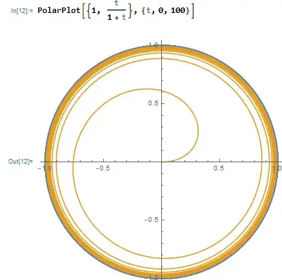

After @jasnee's comment I draw the graph of $Z$ as follows
It seems the graph of $r=\frac{\theta}{1+\theta}$ touches $r=1$ as $\theta \rightarrow \infty$. But except that infinity, their graph disjoint. So I guess $Z$ is not path connected, since there are no path connecting points in $S^1$ and $W$.
