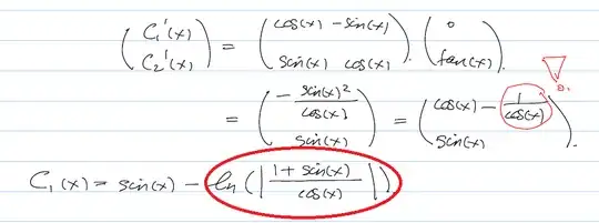

Here's what my teacher got :
What's wrong with what I did ? Did I miss something ?

    @user2336315 Note that since: $$\sec x + \tan x = \dfrac{1}{\cos x} + \dfrac{\sin x}{\cos x} = \dfrac{1+\sin x}{\cos x}$$ this is equivalent to my answer. Looking at your work, you should have done: $$ \sqrt{\dfrac{1+\sin x}{1 - \sin x}} = \sqrt{\dfrac{1+\sin x}{1 - \sin x} \cdot \dfrac{1+\sin x}{1 + \sin x}} = \sqrt{\dfrac{(1+\sin x)^2}{1 - \sin^2 x}} = \sqrt{\dfrac{(1+\sin x)^2}{\cos^2 x}} = \dfrac{1+\sin x}{\cos x} $$ – Adriano Jun 13 '13 at 09:18
  • Towards the end, when you "multiplied top and bottom by $1+\sin x$" you forgot to multiply the top. By the way, the conventional way of putting it is $\ln(|\sec x+\tan x|)$ and there is a quick excessively magic way to do it all in one line. – André Nicolas Jun 13 '13 at 14:18
