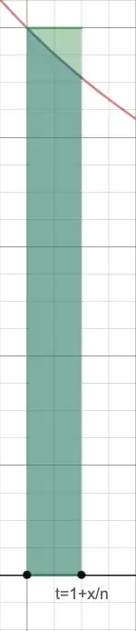

In this answer I define the natural logarithm as $$ \log x =\int_{1}^{x}\frac{1}{t} \, dt \, . $$ and the exponential function as the inverse of the logarithm. This leads to the definition $a^x=\exp(x\log a)$ for $a>0$, valid for all real $x$.
We begin with the fact that $$ \frac{x}{n} \geq \log\left(1+\frac{x}{n}\right) \, . $$ which can be deduced geometrically:
Graph of the hyperbola
$\log\left(1+\frac{x}{n}\right)$ is the area of the region bounded by the hyperbola $y=1/t$, the $t$-axis, and the vertical lines $t=1$ and $t=1+\frac{x}{n}$. The rectangle with a width of $x/n$ and a height of $1$ gives us an upper bound for this region. A little care is needed when $-1 < x/n < 0$, but the result still holds. Hence, $$ n\log\left(1+\frac{x}{n}\right) \leq x \, , $$ and therefore $$ \exp\left(n\log\left(1+\frac{x}{n}\right)\right)=\left(1+\frac{x}{n}\right)^n \leq \exp(x) \, . $$ Note however that this proof is only valid for $\frac{x}{n}>-1$. If $\frac{x}{n} \le -1$, then $(1+\frac{x}{n})$ is nonpositive, and so the definition $\exp\left(n\log\left(1+\frac{x}{n}\right)\right)=\left(1+\frac{x}{n}\right)^n$ no longer applies.
