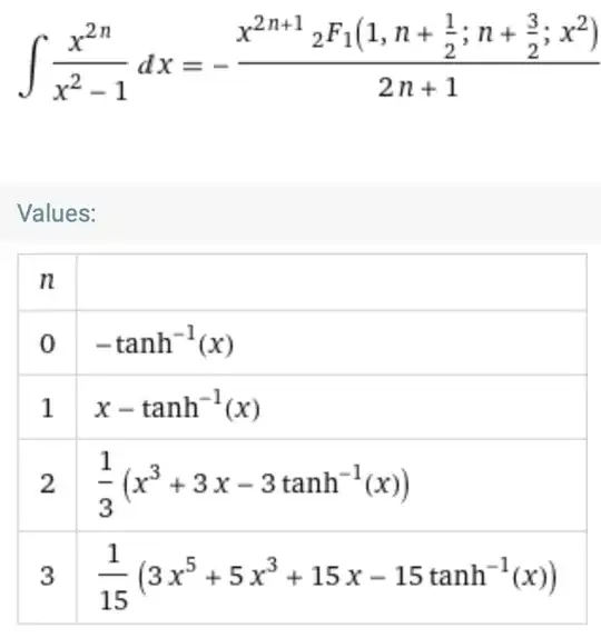

I think we can get a closed form. For that we simply solve
$$\Delta I_n +4 I_n = \frac{1}{2n+1},\ I_0 = \frac{\pi}{3\sqrt{3}}$$ (credit of @Martund) with which we obtain
$$I_n = (-3)^n\left(C-\frac{1}{3}\sum\left(-\frac{1}{3}\right)^{n}\frac{1}{2n+1}\right)=(-3)^n\left(C-\frac{1}{3}\int^{-\frac{1}{3}} \frac{t^{2n}}{t^2-1}dt\right)$$ and so
$$C=\frac{\pi}{3\sqrt{3}}+\frac{\ln\left(\frac{4}{3}\right)-\ln\left(\frac{2}{3}\right)}{6}=\frac{\pi}{3\sqrt{3}}+\frac{\ln(2)}{6}$$ thus
$$I_n =(-3)^n\left(\frac{\pi}{3\sqrt{3}}+\frac{\ln(2)}{6}+\left(-\frac{1}{3}\right)^{2n+2}\frac{{_2}F_1\left(1,n+\frac{1}{2},n+\frac{3}{2};\frac{1}{9}\right)}{2n+1} \right)$$
The hypergeometric series above should always have a closed form:
