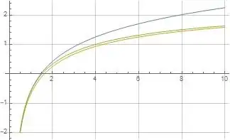

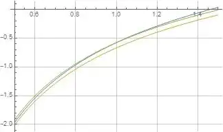

The following two formulas for the digamma function $\psi(z)$ both converge very rapidly as $z\to 1$, but formula (2) seems to converge slightly faster than formula (1), and also note formula (2) evaluates exactly correct at $z=1$ for all values of $K$.
$$\psi(z)=\underset{K\to\infty}{\text{lim}}\left(z \sum\limits_{k=1}^K \frac{1}{k (k+z)}-\frac{1}{z}-\gamma\right)\tag{1}$$
$$\psi(z)=\underset{K\to\infty}{\text{lim}}\left(\sum\limits_{k=1}^K\left(\frac{1}{k}-\frac{1}{k+z-1}\right)-\gamma\right)\tag{2}$$
The following figure illustrates formulas (1) and (2) for $\psi(z)$ in orange and green overlaid on the blue reference function $\psi(z)$ where both formulas are evaluated at $K=10$. As mentioned above, formula (2) illustrated in green seems to converge more rapidly than formula (1) illustrated in orange, and formula (2) also evaluates exactly correct at $x=1$ for all values of $K$.
Illustration of formulas (1) and (2)enter image description here
Figure (1): Illustrations of formulas (1) and (2) for $\psi(z)$ evaluated at $K=10$ in orange and green overlaid on blue reference function
Formulas (1) and (2) above are from the Wolfram functions site.
