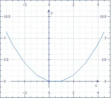

$x\lfloor x\rfloor$ has a discontinuity at every integer, and cannot be an antiderivative. If you look at the successive discontinuities, they are of amplitude $0,1,2,3,4,\cdots$, and cumulated, $0,1,3,6,10,\cdots$.
So we compensate with
$$\int_0^x \lfloor t\rfloor\,dt=x\lfloor x\rfloor-\frac{\lfloor x\rfloor(\lfloor x\rfloor+1)}2.$$
