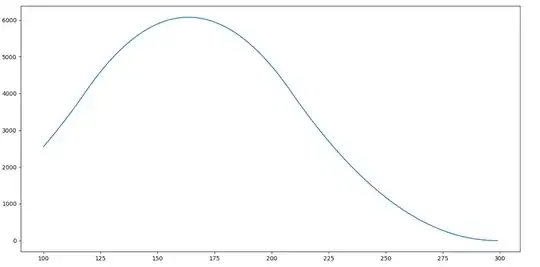

Additional information: Here is the distribution of these permutations:
Plot of how many permutations of two digit numbers there are that add up to n
Here are the individual values and the Python script I used for creating the plot: The script
