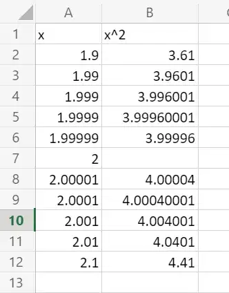

Look at the table showing an estimation method for finding the limit of $f(x)=x^2$ as $x \to 2$ (excel rounded some stuff)
It seems like $x^2$ is approaching 4. However, why shouldn't we say it is approaching 4.0000001.
If we tested values of $x$ between $2$ and $\sqrt{4.0000001}$, we would see that $f(x)<4.0000001$. Therefore $f(x)$ cannot be approaching it.
As a result I said that:
The limit of $f(x)$ as $x\to c$ is not $D$, if $x$ can be made to sit in an interval containing $c$, such that the image of that interval through $f$ does not include $D$
