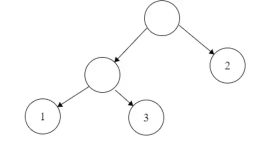

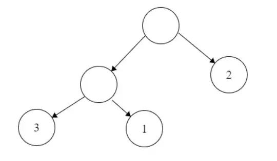

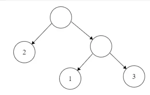

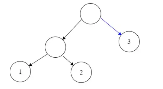

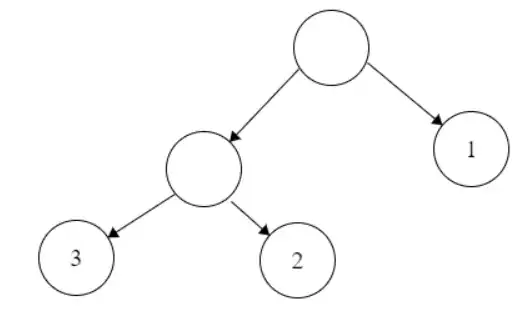

For $3$ terminal nodes, number of possible trees is $3$. These are :
enter image description here enter image description here enter image description here
However following trees are equivalent, and counted only once:
enter image description here enter image description hereenter image description here
