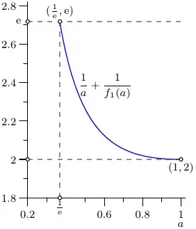

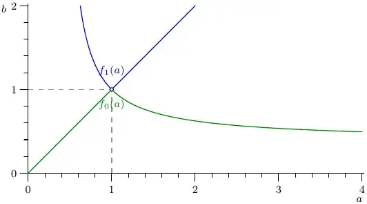

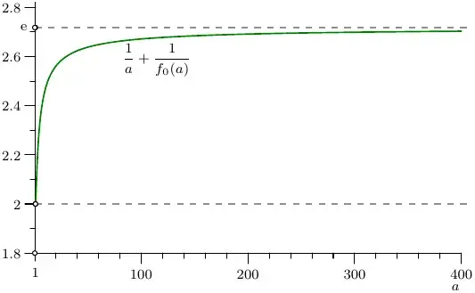

$\require{begingroup} \begingroup$ $\def\e{\mathrm{e}}\def\W{\operatorname{W}}\def\Wp{\operatorname{W_0}}\def\Wm{\operatorname{W_{-1}}}\def\Catalan{\mathsf{Catalan}}$
Given that \begin{align}b \ln a - a \ln b = a - b \quad\text{for } a>0, b>0, a\ne b \tag{1}\label{1}\end{align} show that \begin{align}2< 1/a + 1/b < \e \tag{2}\label{2}\end{align}
Hint. From \eqref{1} there are two solutions for $b$ in terms of $a$: \begin{align} b=f_0(a)&=-\frac{a}{\ln(\e\cdot a)}\,\Wp\left(-\frac{\ln(\e\cdot a)}{\e\cdot a}\right) \tag{3}\label{3} ,\\ b=f_1(a)&=-\frac{a}{\ln(\e\cdot a)}\,\Wm\left(-\frac{\ln(\e\cdot a)}{\e\cdot a}\right) \tag{4}\label{4} , \end{align}
where $\Wp$ is the principal branch and $\Wm$ is the other real branch of the Lambert $\W$ function.
Since the case $a=b$ must be excluded, we need to prove \eqref{2} for two cases:
\begin{align} 1)\quad a\in(\tfrac1\e,1),\quad b=f_0(a) \tag{5}\label{5} . \end{align}
\begin{align} 2)\quad a>1,\quad b=f_1(a) \tag{6}\label{6} . \end{align} Note that
\begin{align} \frac11+\frac1{f_0(1)} &=\frac11+\frac1{f_1(1)} =2 ,\\ \lim_{a\to\tfrac1\e} \left(\frac1{a}+\frac1{f_1(a)}\right) &=\e ,\\ \text{and }\quad \lim_{a\to\infty} \left(\frac1a+\frac1{f_0(a)}\right) &=\e \end{align}
$\endgroup$
